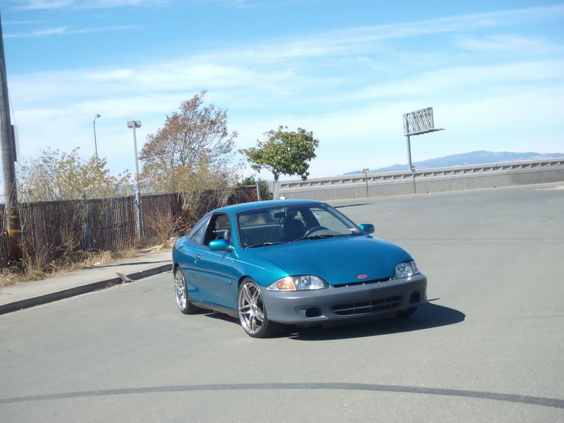

heres my 96 before the headlights and bumper conversion
and she is after.. on hard part is getting the wiring done. not to bad though
