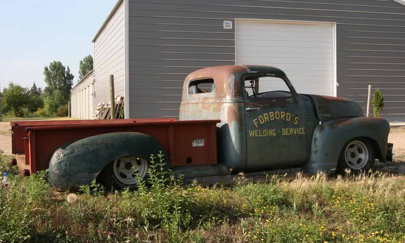

Cool looking truck!

that truck is pretty kick ass! i would love to have a truck like that! more pics or a link to more, please!

seriously.......i want that truck!

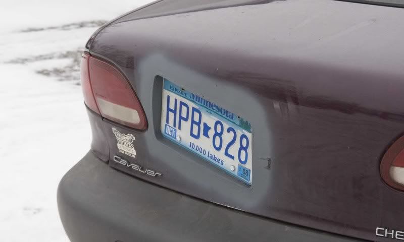

Not too bad for an investment of $3.12 and 2.5 hours.
Re: custom bumper building
Sunday, December 16, 2007 5:38 PM
not bad but what are you doing with the bumper now
Sunday, December 16, 2007 8:15 PM
When it warms up, we will try fiberglassing. I think I will start with a smaller project, a hood blister maybe, then work my way up to a full bumper.. I couldn't get the other pic to post, but my plate light is red. Looks kinda cool at night.
