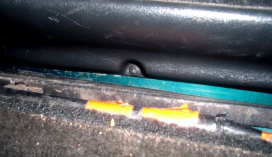

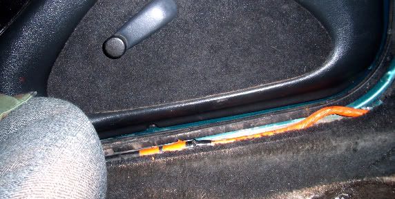

i have the plastic door sill thing off the floor and i can see the screws..so maybe if you can get that off....but i have a 97 sunfire so who knows...you might have to destroy it to get it out with the door closed, but it's just held in by clips so it can't be too hard. and it's probably cheaper than a door panel or door itself. good luck.
