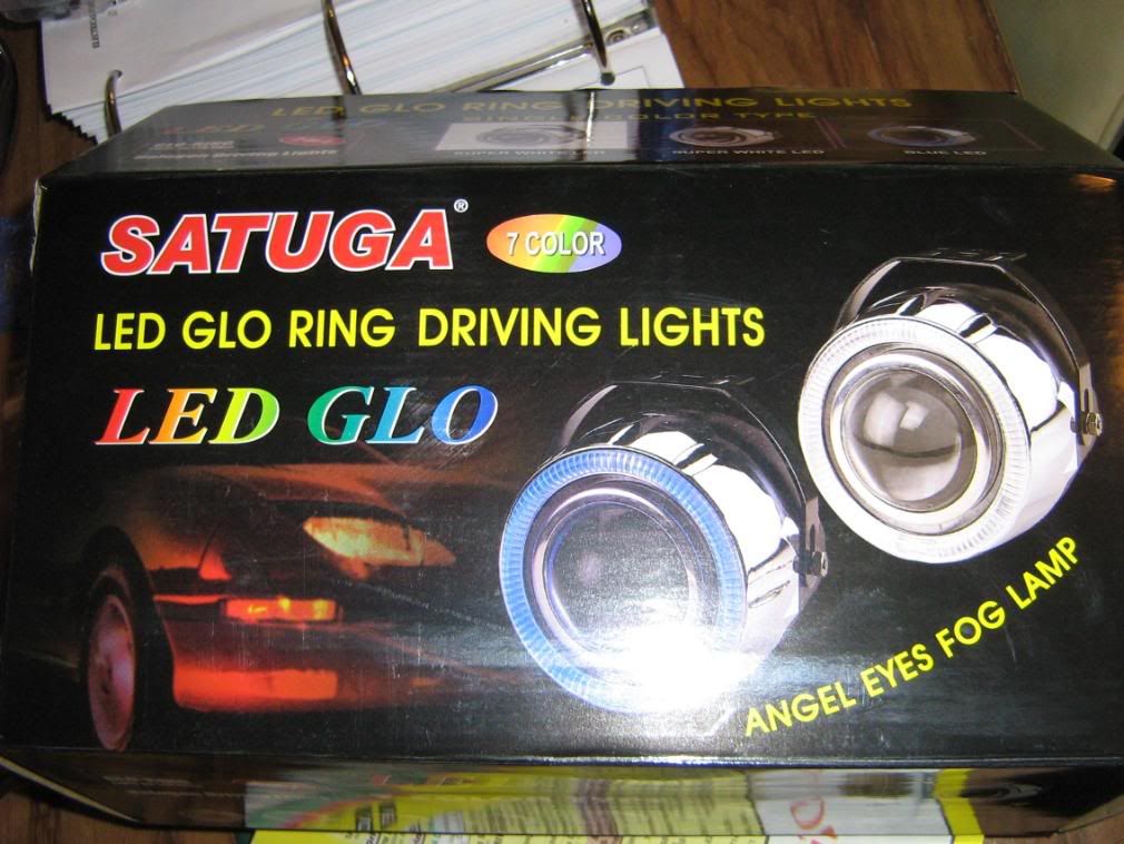

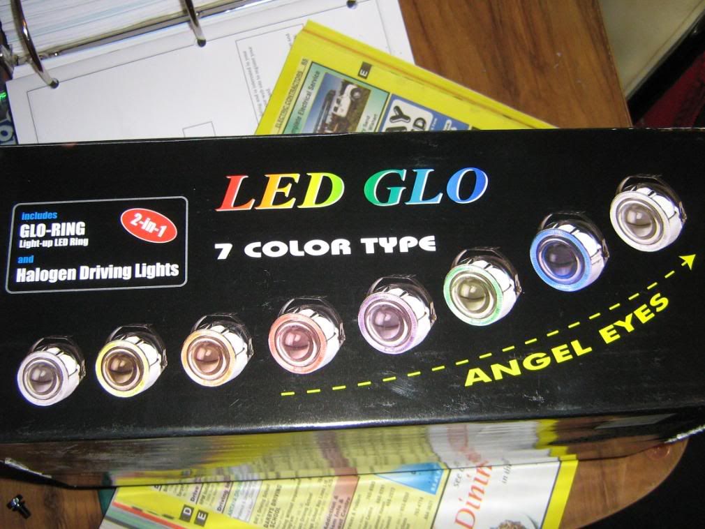

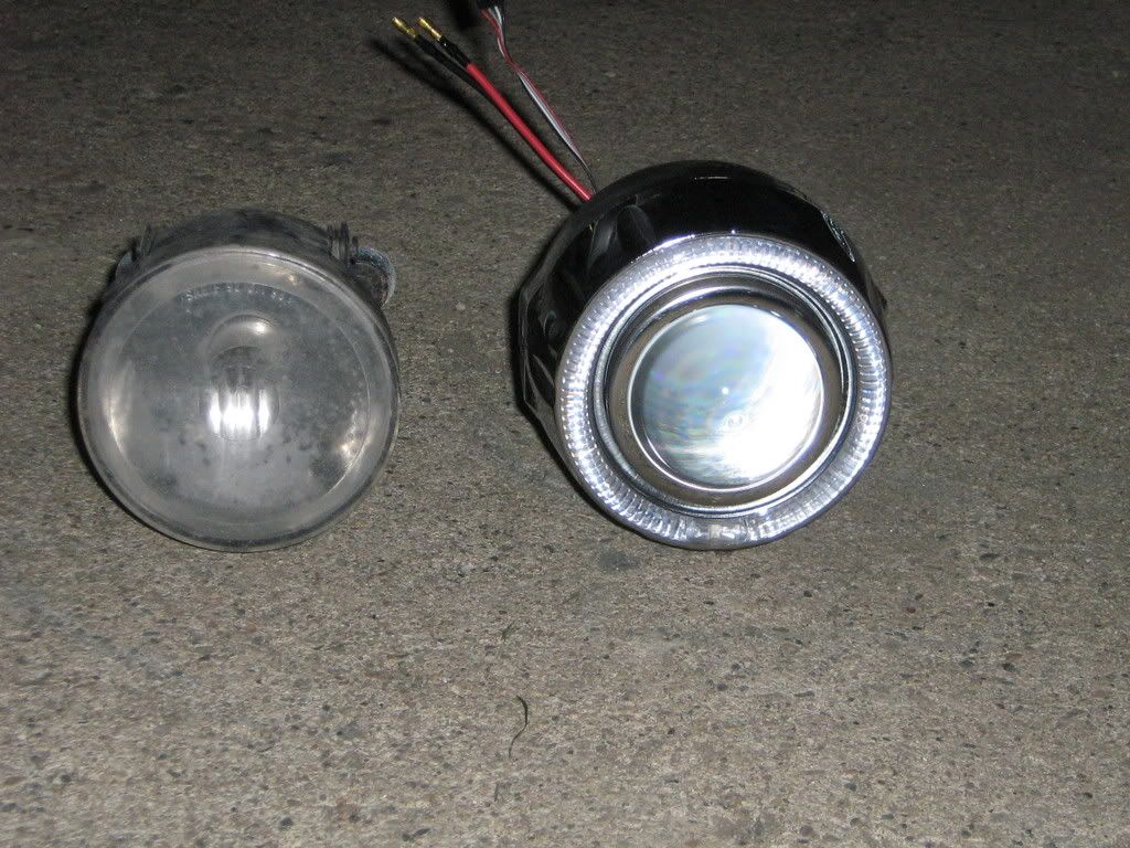

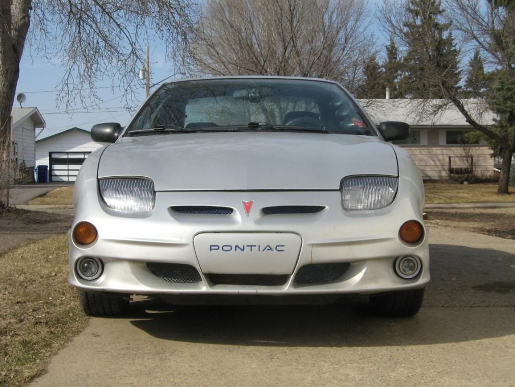

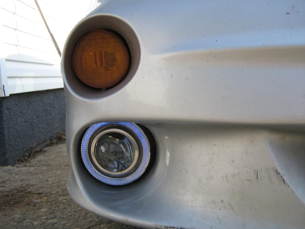

I just got my new projector fogs delivered today. They're a 4" light, 2" projector and a 7 color halo. I set them in the bumper but haven't wired them or anything yet, I'll be doing that this weekend. Let me know what you think. On to the pics...
Before someone says something, in the last pic the bumper looks cracked on the right side of the license plate cover... its just dirty and i didn't notice it until I had the pics loaded onto the computer and was too lazy to get a better pic.

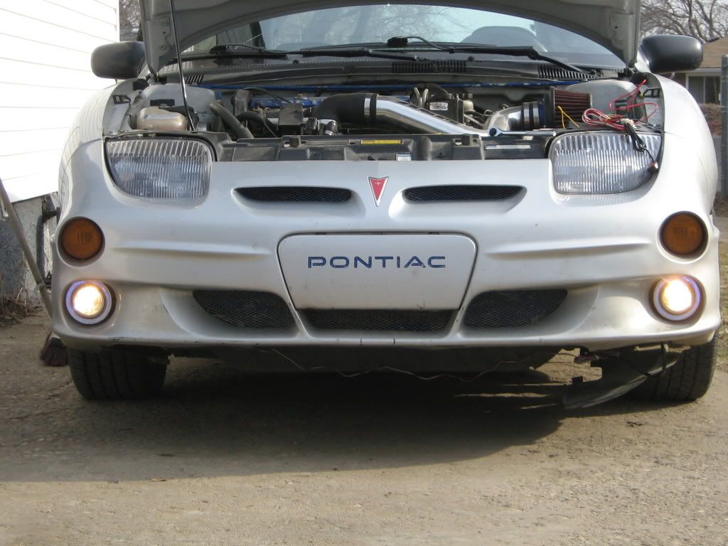

The only thing I'm worried about is that once I have them installed I won't be able to go back to stock. It looks like I'm going to have to cut the plastic tabs that the stock ones mount to in order to properly mount these.
I temporarily wired the halos and fogs to see what they looked like. I'll take some night pics once it gets dark.
Cleaned the dirt off the bumper before I took the pic this time.

looks good. stock bulbs in there? where'd u get em?

tha_prowler wrote:looks good. stock bulbs in there? where'd u get em?
Thanks... According to the specs they have an H3 55W halogen bulb in them. I got them off ebay. $45 plus shipping for the 2 of them.
Re: New Fog Lights... Opinions??(pics inside)
Wednesday, April 23, 2008 4:47 PM
i'd leave the halos off. and there's a sunfire on the box, so i'm not surprised they work

wow... I was so pumped about getting the lights that I didn't even notice the Sunfire on the box.

lol. the box has a fire on it w/o the fogs on it?

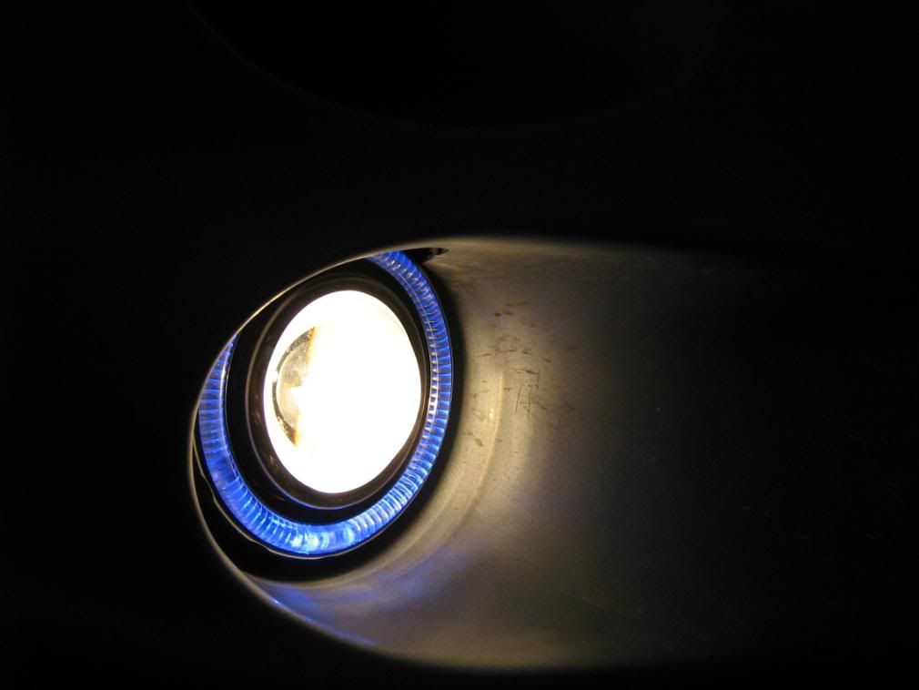

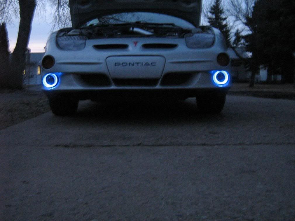

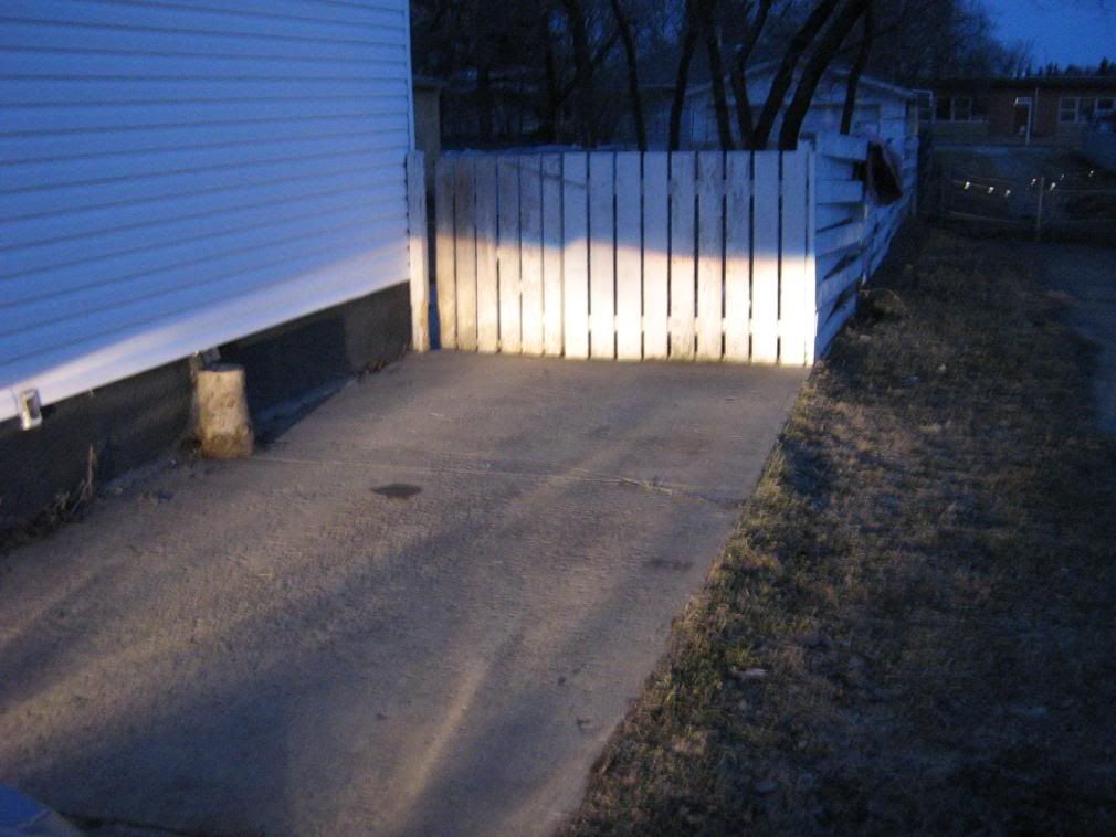

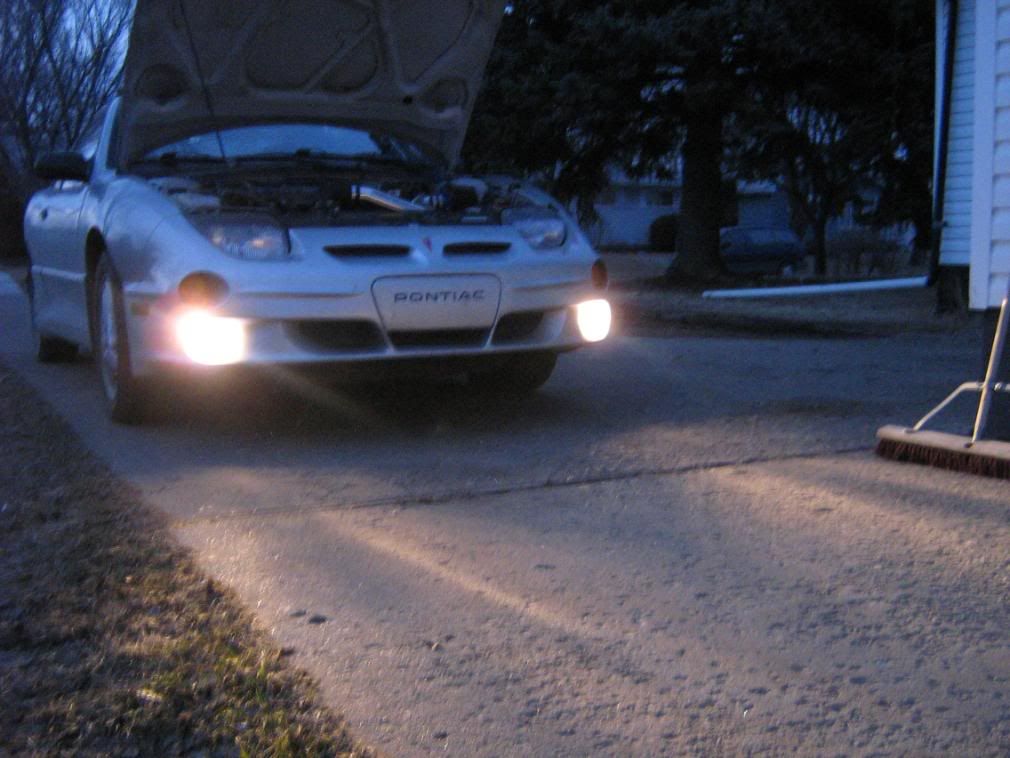

3. I got some night pics... Its not super dark but its dark enough to get an idea what they're like. Sorry about the quality of the pics, the camera battery was going dead.
A comparison of stock and projector
Halos at night (blue color)
Halo and projector both lit.
Output shots keep in mind that these aren't properly adjusted yet

yea you can wire it to stock wiring I did it with a set and it worked fine. I had my halos hooked up to the parking lights and then the bulbs them self hooked up to the stock switch thats in the car. BTW is that a sunfire on the cover of that box?

Those are all over ebay... they look good on the car.
I had my reasons for hesitating with them, though.
That projector is not HID compatible/ready... and with how hot my HID's get in the projectors I DID get (Full cast body and glass lense) I'm glad I went with the option I did because those will melt down under the heat. I'd also wonder if the shroud was far enough forward to clear an HID bulb.
Either way, they look good but if HID is in your future for them be aware that it may not work out for you, which is why I walked away from them.

Thursday, April 24, 2008 8:46 PM
I bought mine here but there's a whole bunch of the exact same ones on ebay from other sellers.
Ya its a 95-99 Sunfire that doesn't have factory fogs

I had one of them apart last night just to see what things looked like inside. The projector itself is a glass/cast aluminum set up mounted inside the plastic housing and the halogen bulb thats in it is pretty long so it might work with HIDs. I can open one up when i get home and take some pics for you guys. I was wondering about the heat from HIDs too. If i go that route I'll probably put some venting or something in the housing.
