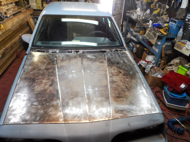

Trying to use all the lessons I've learned on this one. Upon taking off the primer on the top section I discovered it was terribly pitted and had been covered up with some Bondo to smooth out the top. At first it broke my heart to see the damage, but after finishing up with my wire wheel I saw that there at least wasn't any holes. After the first day I came to realize this was the perfect car for me after all, haa haa, at least I couldn't do much worse to it.

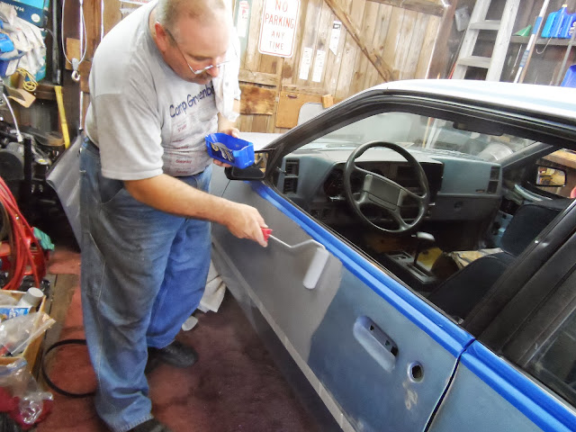

So here are a few befores and afters. I used the 4" foam rollers and laid down 2 coats of rust inhibitor all over the top and rusted areas. Followed with 2 coats of Primer , then 2 Color Coats. After the 1st Color Coat I took a small brush and tidied up any areas the rollers couldn't get to, then tied everything in with the second Roller application. Professional it ain't near to. Much better it definitely is. The Custom color mixed Gallon I got is very thick and lays down a very thick coat. I won't be worrying about rust issues around these areas for a mighty long time - that was the goal.
Went today and picked up my Custom Mixed Gallon of Dark Blue to 2 Tone the car with. Picked it up on sale at the hardware store today with a 25% Discount Coupon - so this Bucket of Paint only cost me $25 today. I'll take it to my local Napa and have them add some metal flake to it , mix it up, and pour it into 4 quart cans to make it easier to work with.Ran across a Quart of Dark Red that was a Return while I was there for just $3 that I'm planning on using to Stripe and trim a little with.
I'll have to get a couple of photos to show, but I found I can take a used quart oil container and cut it from bottom to top- just after the neck. This makes a perfect container to pour my paint in and use the 4" roller out of. When I'm finished, I just pour what is left back in the can and toss the oil container in the trash.

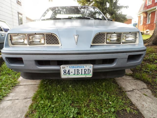

Bottom line is that it looks good going down the road and it's all one color. They call that a 20 footer and thats OK because it's keeping the rust gremlins away.

And now as promised......(or dreaded - LOL) here is my 0 cost solution to a container to use for painting with a 4" roller. Took awhile to come up with this cookie.
Save your left over 1 quart oil containers. I doubt the fancy ones Castrol and the like will work, but you can give it a try. They seem like they might be a bit too shallow. I grab these at work after they change the oil on the fork lifts and the work pick-up truck.
Simply pour the paint in the container , use.....pour left over back in can. It works wonderfully!!

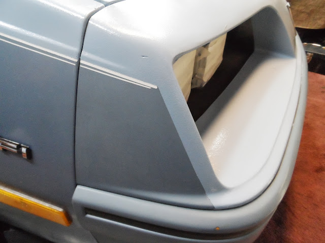

Decided to go ahead and paint down to lower beltline. I got a 5 day break coming up next week and hope to get the lower two tone rolled on then. So I'll get this mid section painted this weekend and allow some drying time and bolt the hardware back together next week. The whole car is blending in nicely since the whole body is having the same texture. This method produces no paint runs too - which is a plus.
Primer done on sides now :
Going this route scrapped the small line angled to the bumper I originally had - most painting this would have been a nightmare to change out, but a small feathering and it blends right back in!!
Had to take the tail lights and center piece back out....Darn it!! LoL The Gas Filler Door has proved to be a heck of a piece to get painted up.
The hardware was incredibly easy to remove - I taped all that up when I Rattle Canned the Wagon. Next time I'll pop the door panels off!! Hoping that I got the lower beltline taped off correctly...... Guess I'll find out after the 2 color coats are applied tomorrow!!
