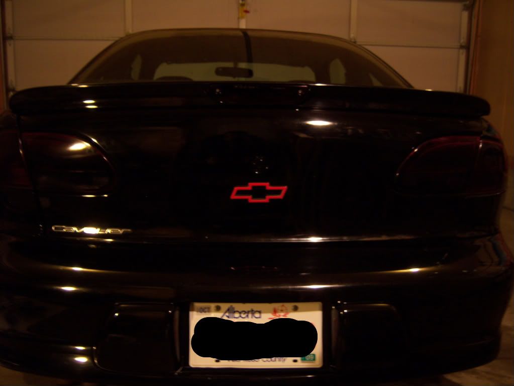

All done. I think it looks awsome. I sprayed about 3 medium coats so there pretty dark but I like them that way and they still shine through fine
daylight pics? they look pretty good and shiny from what I can see...
Did I mention I drive a 2000 Lumina now?-----wigm-tuners.org member
sry I didnt get any daytime pics yet but I will try tommorow and ill post, defs worth it only cost me 11 dollars
