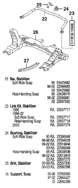

I'm ordering the Eibach sway bar kit soon and i dont currently have a front bar. what i need is does anyone know the GM part # for the front d bushing brackets? also, if the front bar doesnt come with endlinks, does anyone know the part #'s for the energy suspension endlinks for the front?

the D bushings and brackets that hold the front sway bar to the subframe

the ends of the sway connect to the control arm...
Do you want the Insulator's and clamps that go around the stabalizer shaft ? If so I can give you the part number for that if not please let me know what it is

that is exactly what i am talking about. all i need is the clamps but i guess i have to buy the insulators too.
anyone have the part #'s for the energy suspension endlinks for the front?
Bracket, Stabilizer
95-99 R/L 22587935
00+ R/L 22660396
I don't know why there is a difference in years, but that is what the book says. Those part numbers are for the brackets only, without the bushings.
please be aware that the bolt that holds the stabilizer bracket (#25) in also changed in 2000. found this one out the hard way. be sure to them them what year car you have or your VIN handy.

MoNkeE: i no longer have it, BUT all you have to do is what i did...call the parts dept and ask then what the correct size is for the bolt that holds the inner bracket for your year car. I think is a 10 x 1.5 but I'm not for sure, I thought i wrote it down in my manual but not dice man.
