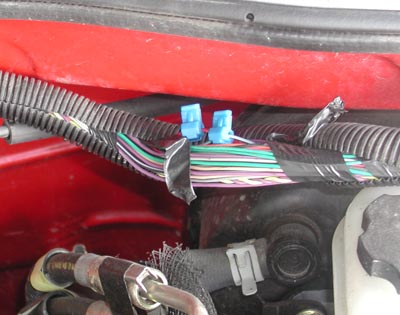

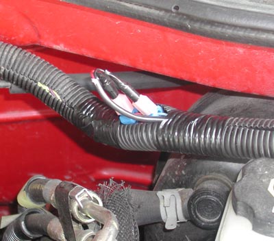

ok, I got mine installed, worked great and I think it came out as a cleaner install. once I solder the wires you won't even know it's there.
3 red w/ black stripe , 2 blue w/white stripe
so I had to use a continuity tester to figure out the right ones in the harness to the PCM
and the wire thru the firewall...
Solder? we don't need no stinking solder
well, they will be eventualy.. but not today.

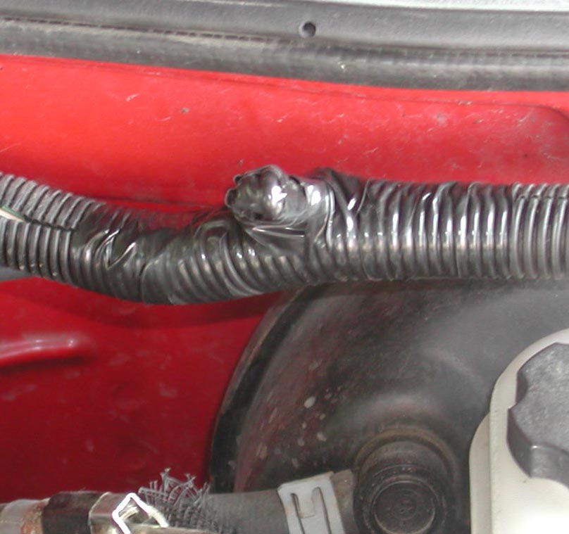

And the finishing touches.
